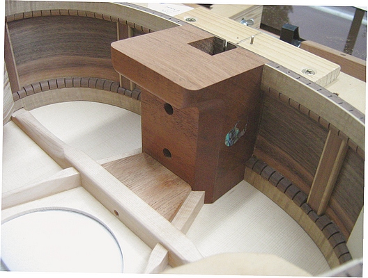

When I radius the braces on the respective dish position , I have the top of the brace double taped to a firm straight piece of wood (stiffenner), which won't let the brace bend . I also have a straight wooden fence straddled across the top of the dish to keep the brace and it's stiffener at it's upright angle , so it won't tilt while being radiused.
Another big consideration ( for me anyway) , is when I install the Lowden type A Frame braces . I use a rather heavy A frame , so the soundhole braces are notched , and the upper transverse is also notched to receive them . The A frame set up is also let into the headblock. With all this going on , The braces have to be at a predictable angle for all notches and pockets to line up properly for a good fit.
Now ,,,Brace yourself.....
I'll bet it's just not you and me , Hesh ,Bro, Mate
CRAIG LAWRENCE of AUSTRALIA
PostPosted: Wed Apr 25, 2007 10:50 am
Posts: 720
I was just trying to show how I keep the braces upright on the dish ,and the reason why I do it.
That.........and to show off my latest ONCE AGAIN !

Thanks Kim , Hesh and Hodges Guitars. I haven't meant to hijack the thread . I just wanted to make the point that this type of brace work needs to have all braces at the same upright angle . To have them all angled towards the middle of a sphere would mean compound angles on the notches and headblock pockets ,,,,( not good )....
I don't think maths is needed here . As I said above :
Sanded,like mine ,Hesh's and I think Tracy's = braces of similar upright angles.
Sanded in their unrespected dish areas = braces ,all tilted towards the middle of the sphere.
Not a,lot of difference,,,,,, except when your installing bracework like mine above.
